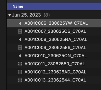

08-14-2023 07:02 AM
10.6.8 has not fixed this problem. The three clips showing as audio only in the screenshot below are the same three that weren't working before.
