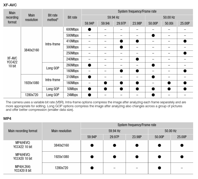

Your camera records in XF-AVC and MP4. It does not support Cinema RAW or Cinema RAW LT. Let me do a few minutes or research for the other questions.
| XF-AVC Compression: MPEG-4 AVC/H.264 Color Sampling: 4:2:2 10-bit File Format: MXF Recording Modes: ■ Resolution: 3840x2160 (YCC422 10-bit) 260 Mbps Long GOP (59.94P/50.00P) 410 Mbps Intra-frame (29.97P/25.00P/23.98P) 160 Mbps Long GOP (29.97P/25.00P/23.98P) ■ Resolution: 1920x1080 (YCC422 10-bit) 310 Mbps Intra-frame (59.94P/50.00P) 160 Mbps Intra-frame (29.97P/25.00P/23.98P/59.94i/50.00i) 50 Mbps Long GOP (59.94P/50.00P/29.97P/25.00P/23.98P/59.94i/50.00i) ■ Resolution: 1280x720 (YCC422 10-bit) MP4 Compression: MP4 (HEVC): H.265/HEVC MP4 (H.264): MPEG-4 AVC/H.264 Color Sampling: MP4 (HEVC): YCC422 10-bit/YCC420 10-bit MP4 (H.264): YCC420 8-bit File Format: MP4 Recording Modes: ■ Resolution: 3840x2160 (YCC422 10-bit) 225 Mbps (59.94P/50.00P) / 135 Mbps (29.97P/25.00P/23.98P) ■ Resolution: 1920x1080 (YCC422 10-bit) 50 Mbps (59.94P/50.00P/29.97P/25.00P/23.98P) ■ Resolution: 1280x720 (YCC422 10-bit) 12 Mbps (59.94P/50.00P) ■ Resolution: 3840x2160 (YCC420 10-bit) 170 Mbps (59.94P/50.00P) / 100 Mbps (29.97P/25.00P/23.98P) ■ Resolution: 1920x1080 (YCC420 10-bit) 35 Mbps (59.94P/50.00P/29.97P/25.00P/23.98P) ■ Resolution: 1280x720 (YCC420 10-bit) 9 Mbps (59.94P/50.00P) (2) MP4 (H.264): (YCC420 8-bit) ■ Resolution: 3840x2160 150 Mbps (59.94P/50.00P/29.97P/25.00P/23.98P) ■ Resolution: 1920x1080 35 Mbps (59.94P/50.00P/29.97P/25.00P/23.98P) ■ Resolution: 1280x720 8 Mbps (59.94P/50.00P) |

Shooting in LongGOP vs IntraFrame. Basically this. LongGop captures only the difference between the captured frames. Less processor intensive, smaller files. IntraFrame (All-I) captures every frame individually. Larger files and more processor intensive. This is a representation of how each affects file size. The higher bit rates and resolution are capturing more detail. This is at the expense of file size. Becoming familiar with proxy recording can help with this.
