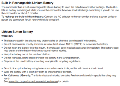

When the main battery is changed the date and time are lost and must be re-entered. I plugged in the camcorder to power overnight which did not have any effect. Is there an internal battery to be replaced?

dsenechal57:
What is going on here?
Where are you seeing in the manual that there is a CR2025 battery in the camera? It does not say that, period! Yes, there are cameras that DO use CR2025, in a user-replaceable holder. The XF305 is not one of them. It's battery IS NOT user replaceable, and a Canon person should have been able to tell you that, just by referring to the camera manual.
Leejr . . . Glad that you sent the camera in to have the battery replaced.
04-02-2024 02:10 PM
May I ask what they charged you to replace the battery?
04-02-2024 02:16 PM
Page 197. Two references to a lithium battery, the latter of which mentions a CR2025 "lithium button battery". There is no mention of a remote or any other accessory, leading to an understandable assumption that the CR2025 was the camera's date/time battery.
04-02-2024 04:33 PM - edited 04-02-2024 04:41 PM
Here it is, page 197 of the XF300/305 Manual, dated 2016, on the Canon Support site as we speak. The word "CR2025" does not appear. Your assumption is not correct. No idea what the battery is. Could be some non-standard one, and possibly soldered-in. In any case, it doesn't matter. Still not user-replaceable.
Is this the manual you are looking at?
