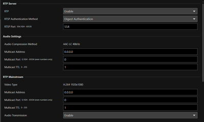

Hello,
I just got the CR N300 camera and I'm trying to understand how to get the RTP server to work.
I can access the webpage and control the camera from there, but I would like to use the rtsp protocol to see the video from VLC.
Below are my RTP settings:
I always get an error, what do I need to change in order to make it work?
I'm not sure I understand this settings page...
01-31-2024 03:57 PM
I have tried, not successfully, as said in the manual with this URL format: rtsp://<ip>:<port>/rtpstream/config1
02-02-2024 06:14 PM
Hello rookie1,
