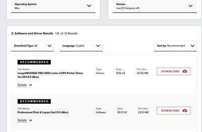

Are these the software items you have installed:
11-25-2024 09:52 AM
Using Canon PPL has resolved the issue.
Borderless printing is back on!
