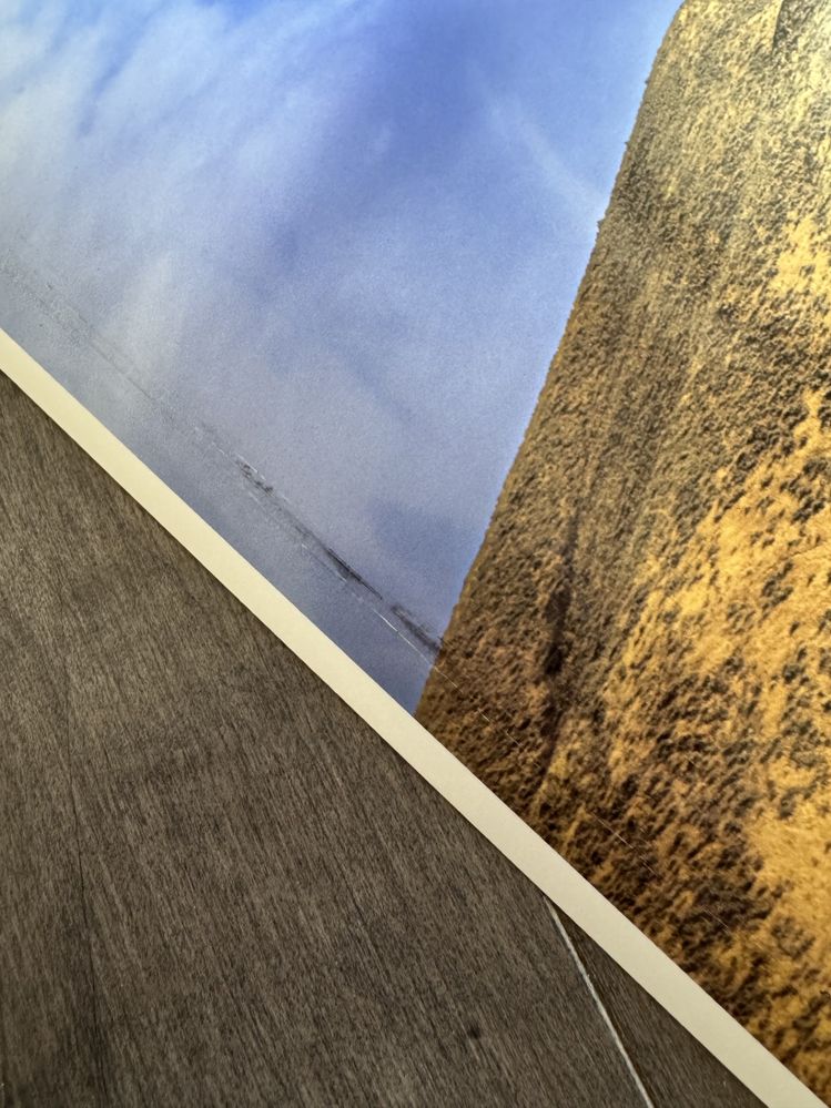

PRO 1000 prints weird line in the beginning of the print.
It just started doing it on pretty much every large format prints.
Printer head is clean and test print is perfect.
Any idea?
11-23-2024 08:40 PM
Sure looks like a head strike. In your driver settings and you selected "avoid paper abrasion" or something to that nature?
