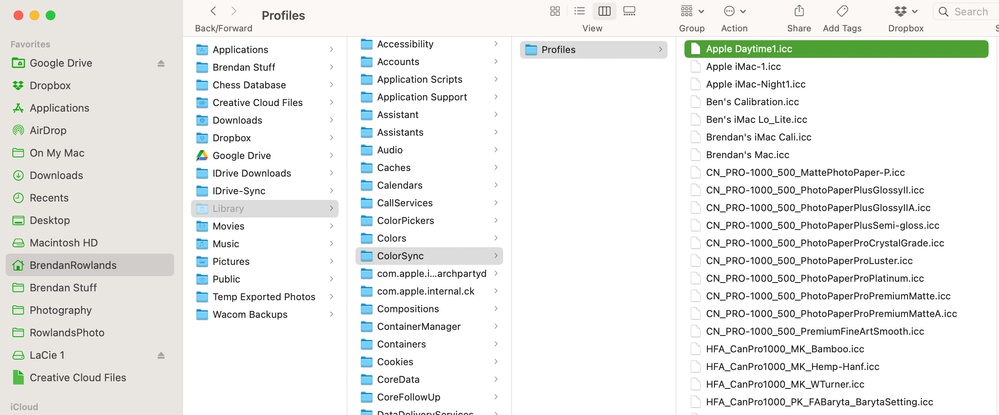

Hello.
I have been trying to install and use the icc profile for Hahnemuhle FineArt Baryta 325g but it does not appear in the list of available profiles when I have the printer controlling the color and using the ColorSync option. I have down loaded other profiles for Bamboo, Hemp and William Turner to see if there was a bigger issue. Bamboo and WTurner are available but neither the Baryta nor the Hemp are visible in the list. Also note, that when I select that Photoshop control the color all 4 of the profiles are available.
I have a Canon PRO-1000 with the most recent driver (version 22.22.0.0) and using Mac OS Big Sur version 11.6.2.
Can you please help me resolve this issue, thanks
Brendan

There is an ICC profile problem with Big Sur newer than 11.6.1.
Updating to Monterey will resolve the problem, as will downgrading to 11.6.1 (but that is easier said than done).

I upgraded the OS to Monterey overnight and I check this morning- The solution you suggested has worked so thank you very much for that tip!!

The issue in Big Sur is present in Monterey again. Some profiles version 4.3 are not show in Apple ColorSync and are invisible in some applications. Open a ticket with apple.
