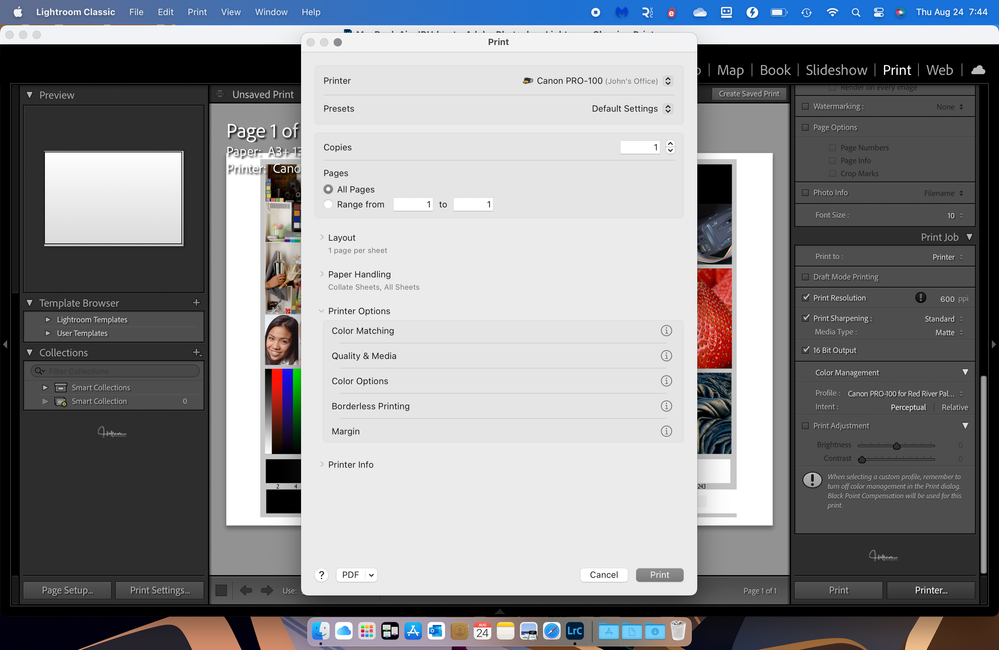

In Lightroom, very that you selected the correct ICC profile in the right side and then when you select Printer button verify that you selected the correct Canon media type.
It should happen automatically, but verify that ColorSync is selected and grayed out in Color Options.
Screenshot 2023-08-24 at 7.44.29 AM.pngScreenshot 2023-08-24 at 7.44.29 AM.png
I have read that there is a problem with Ventura printer system that resets some settings. I don't normally print from my MacBook, but I will run a test print to see what I get.
