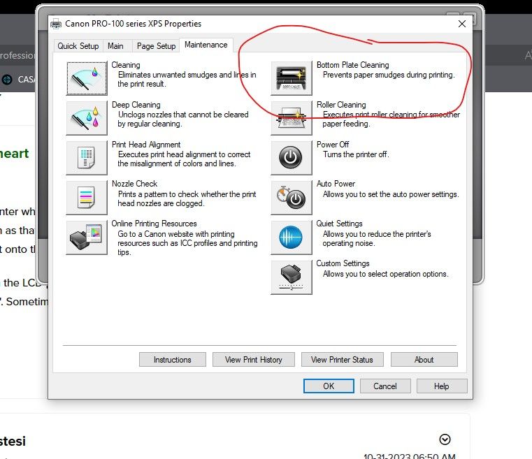

You could also try:

Did you ever find a solution? I tried both turning on "prevent paper abrasion" and cleaning the bottom plate and I'm still getting streaks every few prints, especially after a dark print. I'm using Canon matte photo paper.
