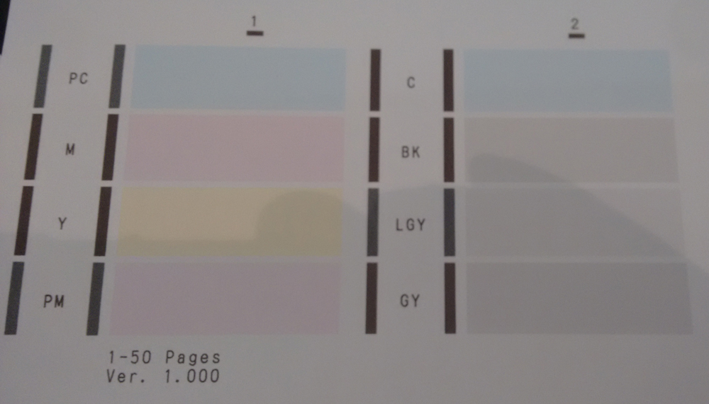

Its a little hard to tell from the image, but it looks like your PC test block is darker than your C.
Verify that you haven't switched the locations of the PC and C ink cartridges.

No, the PC and C are installed correctly.
On the nozzle check print the PC is just a different shade of blue, not really lighter than C.

I don't have that problem with my Pro-100 when I print the Outback test image. If the inks are installed correctly and you have the current driver (downloadd from the Canon support site) perhaps its printer variation.
You could print a test pattern and find the adjustment that gives you the look you like best.
