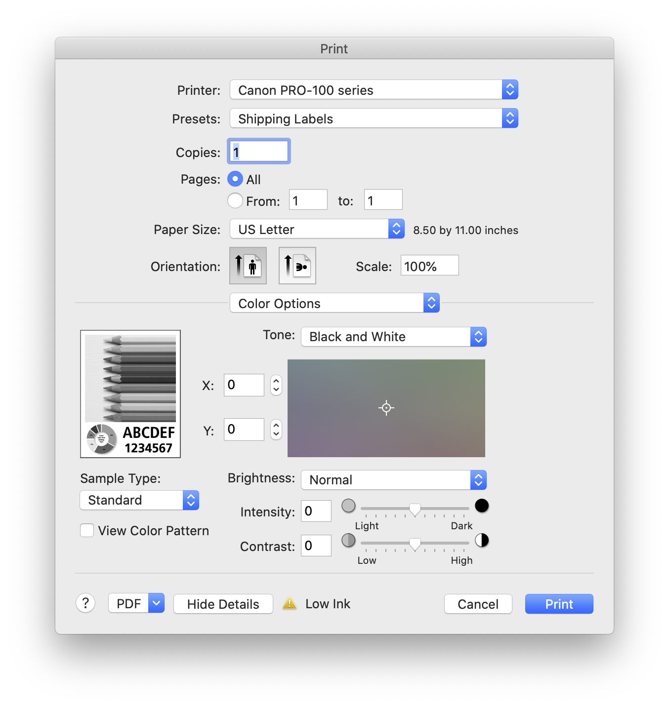

Here are screenshots of what I see in 16.40.1.0:

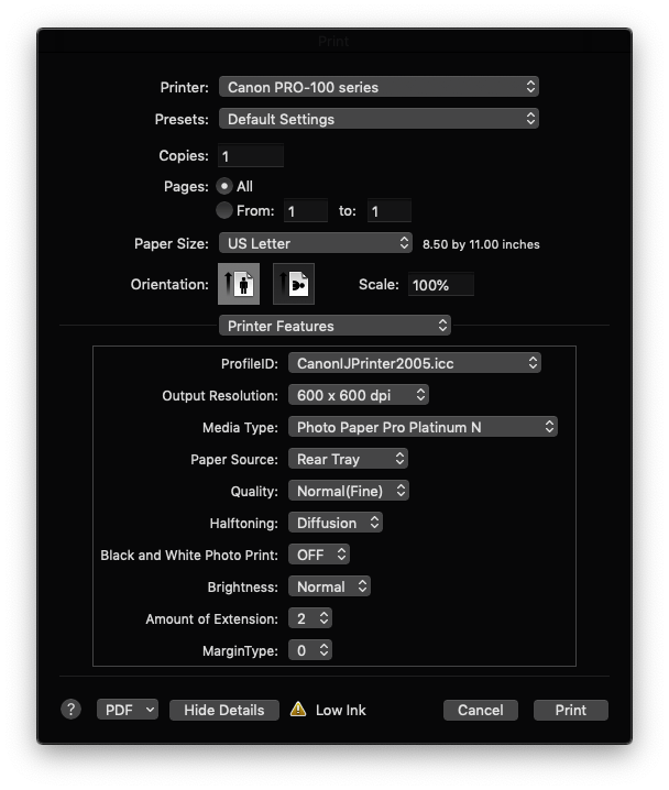

And here is what I see with the newest driver, 16.41.0.0 ... notice how the previous dropdown menu options are missing, and the only option available to me gives a very dry and technical set of options, almost as if it is a developer kit or something. Color adjustments are missing, as well as borderless options, to name a few:

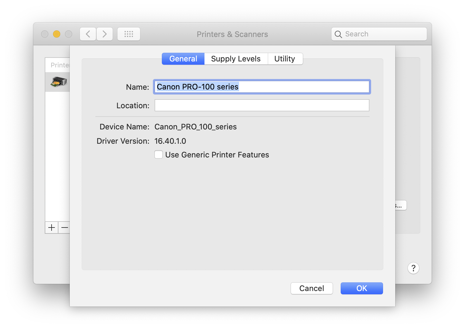

In Printers & Scanners, make sure you do not have Use Generic Printer Features selected under the line for 16.41.1.0.
I just tried on my computer and if I select the check box I get what you have.
Unchecked I get the full option set.
08-11-2020 08:06 PM
Thanks for your reply, John. Unforunately, for some reason, 16.41.0.0 doesn't have that checkbox, but I am familiar with the option because 16.40.1.0 does have it. Do you know why this might be? See screenshots below.
Also, I noticed that you said "16.41.1.0" - was that a typo? Right now, the Canon USA driver page is inaccessible, but I can access the Canada page and there isn't a 16.41.1.0 download there. Just 16.41.0.0.
In the 16.40.1.0 options:
In the 16.41.0.0 options ... just completely missing that checkbox!:
