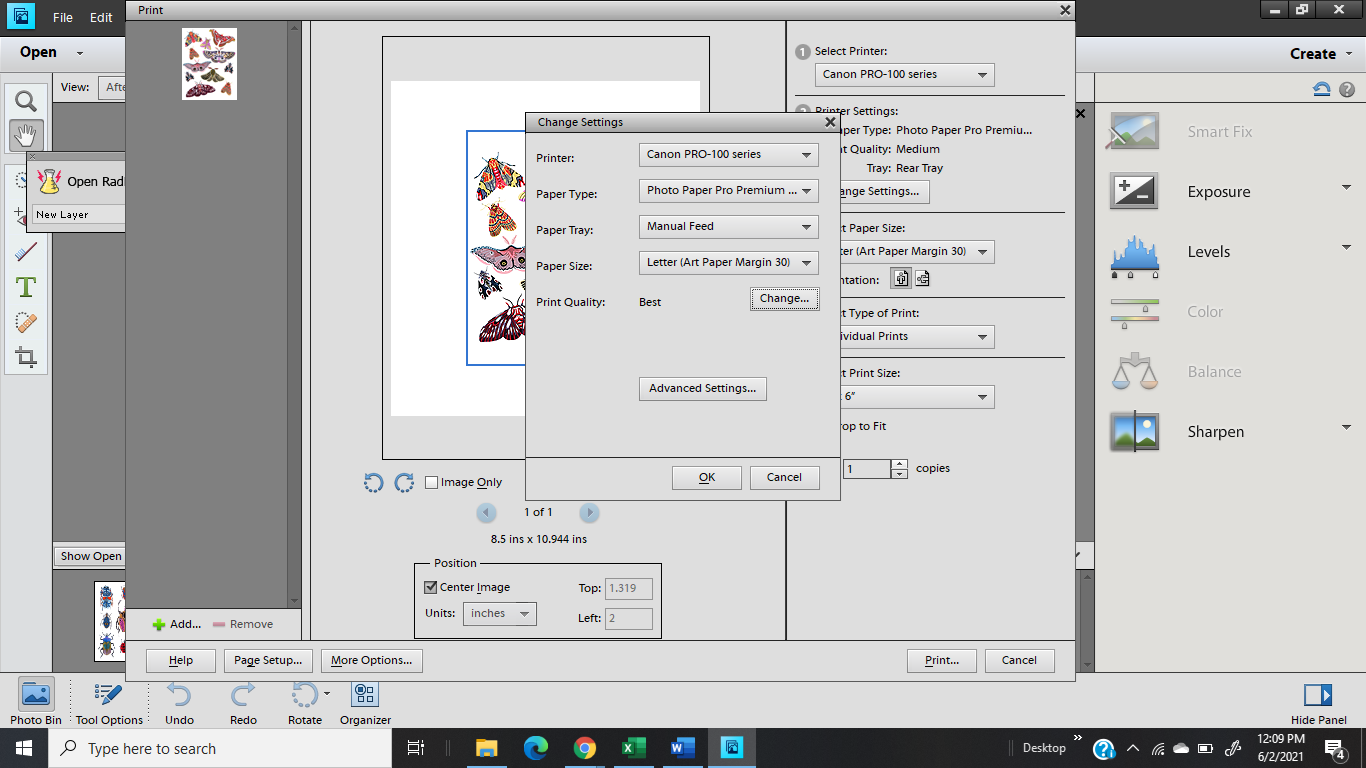

Can you post how you are setting up your print settings in the print dialogue window?
You could download the Canon Print Studio Pro app which will work through Photoshop Elements.
John Hoffman
Conway, NH
Everything looks right to me.
