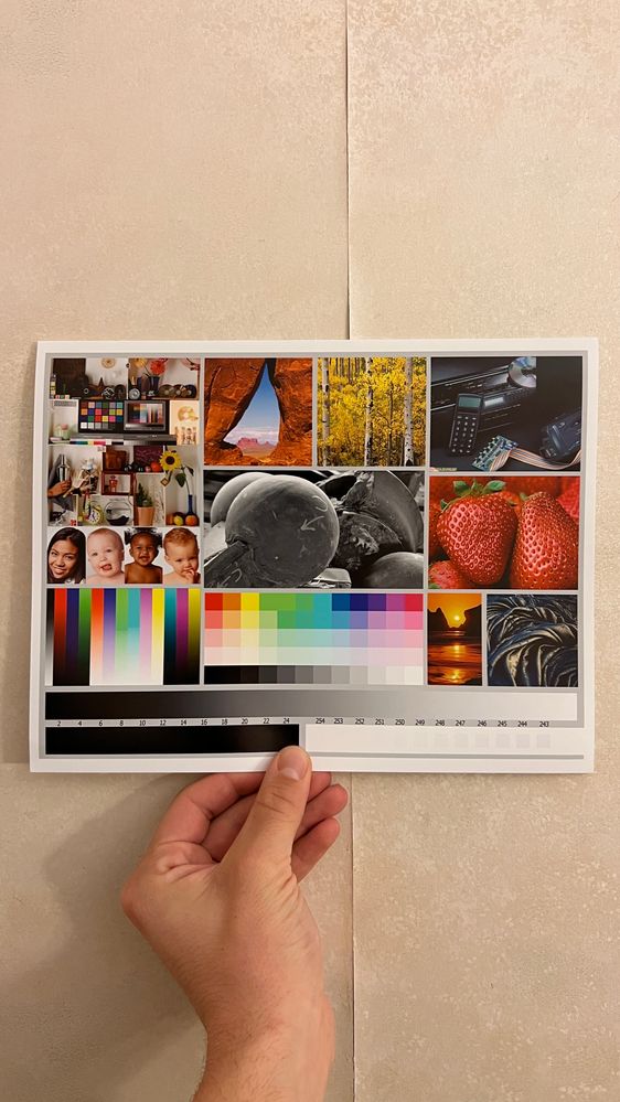

I proceeded to print a color test image, where there were some noticeable issues. IMG_4511.jpgIMG_4511.jpg
Starting at the color bars on the bottom left, bars 3+6 both print as purple, while bar 3 should be a truer blue. Bars 7+8 also have streaking half way down? Not sure what to make of either of those issues. In the next section over, the deep blue box (4 from right side, top row) once again prints as purple. It may not show it in the image i captured, but in person, it's definitely purple.

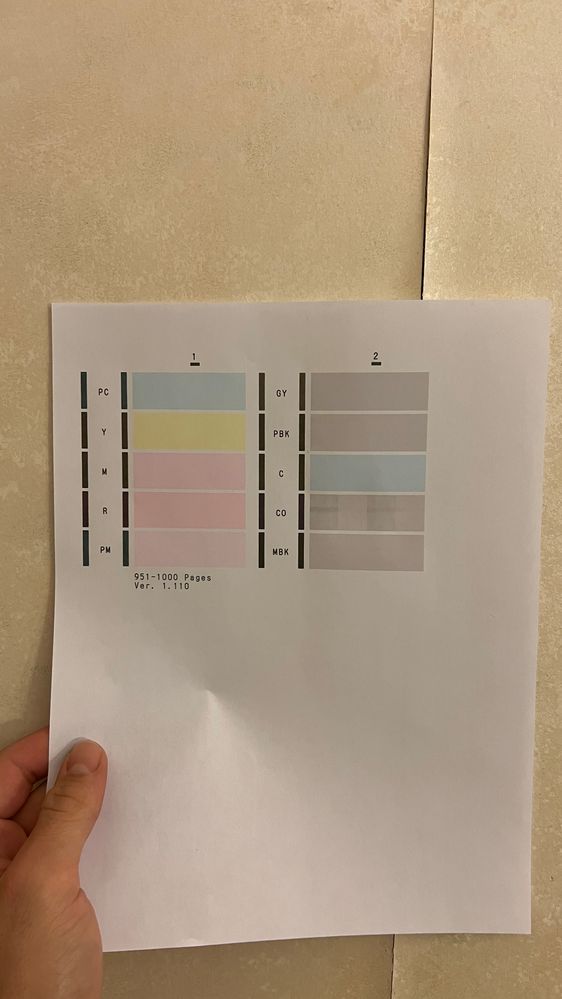

Not sure if I should perform more cleaning cycles, or try something else? I have also attached the most recent nozzle check. Thanks in advance!!

Image look shaded towards red in the photo.
What paper are you printing on? What OS? Are you having printer or software manage color? Proper ICC profile being used?
