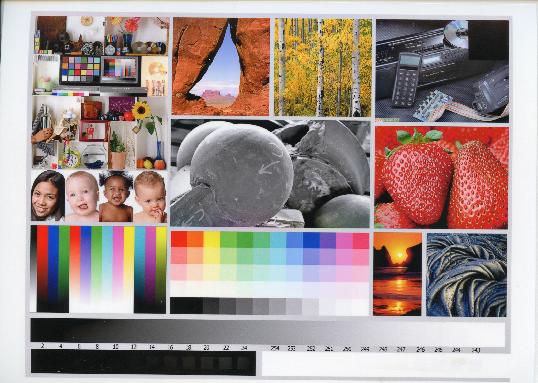

John, this is a continuation of a conversation we had last year which I have never resolved. I did something yesterday that was interesting. I have attached a standard sample picture I downloaded and then a copy I printed which I then scanned. Here is the mystery . Allowing for a lack of "brightness" due to the quality of my scan the colors look pretty close. That is not the case when I am comparing the print to the screen. In other words when the print is placed (scanned) to the screen they look the same. I understand duplicating the screen may not be %100 possible but maybe this is a screen issue. When I calebrate there are two options, one says photography and the other printing. Brightness goes from 100 cd/m2 (I don't know what that means) to 80 cd/m2 and White point goes from 5500 to 5000. Am I creating unrealistic conditions on my screen that can't be duplicated in the print? I would be imterested in your thoughts.
01-17-2021 02:30 PM
Hi.
Those two parameters (brightness and white point) are two areas that get a lot of discussion and recommendations.
cd/m2 is a unit of brightness measurement (candelas per square meter). Lower is dimmer/higher is brighter. The proper value depends heavily on the lighting conditions in the room where you are editing your images.
A common complaint from folks is "my prints are too dark". That is typically because their screen is too bright and when they edit they reduce the exposure. That is why the instructions for the Outbackphoto test image says to just print - do not make any adjustments. The file is correctly adjusted to give a proper print. One thing to verify is that your photo editing software isn't applying any initial adjustments; you want to be sure the test image is being printed "as is".
In your situation which print (80 or 100) is closest to the monitor brightness? That's the setting you would want to use so that when you edit your own prints they come as close as possible to your monitor.
White point setting it is influenced by the viewing conditions of the print. The "industry standard" viewing lighting for professional settings is, from what I have read, around 5000K. So if one is printing for exhibition they would set their monitor to 5000K.
For general use in a home the lighting conditions are closer to 6500K. Here is a little document by Xrite.
Monitor Calibration - Which White Point is Correct? (xrite.com)
Some feel 6500K is too blue. I have followed the recommendation to set my white point at 5800K since photo paper tends to be warmer than 6500K.
In the end, 1. you are correct, the print, being frontlighted will never look exactly the same as the monitor, which is backlighted. 2. the proper settings are the ones that give a good match when you print a standardized test image. That way you can have confidence that the print output of one of your own images will match the screen.
After a lot of evaluating I have standardized on 80 cd/m2 and 5800K for my calibration settings. That gives me a good match between screen and print. I'm only showing my prints in my home, not a gallery. I also have low background lighting when I edit to be sure that there is no light falling on my monitor screen.
