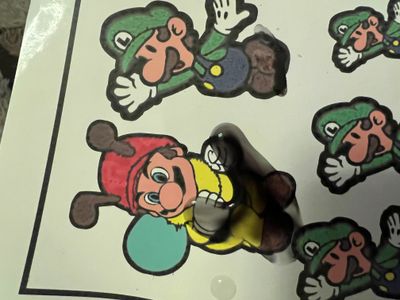

Hello
I just got a Canon Pro 200 printer, and the print quality is great on all types of paper, but there is a problem with printing on glossy sticker paper, the quality is poor and there are bubbles in the ink, despite attempts to change the paper type settings from the print and program, but I did not get a satisfactory quality
