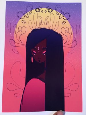

and HERE'S how it's coming out
You can see how dark it is right??
I've literally tried brightening the picture, fixing the contrast, but it stays the same!!
Can someone help me because it's such a minor issue but it won't fix !!
I'm starting to think maybe it's the color of the paper that's making it darker? Since no paper is pure white.... (When I put it on a light behind it, I can actually see it's true colors...)

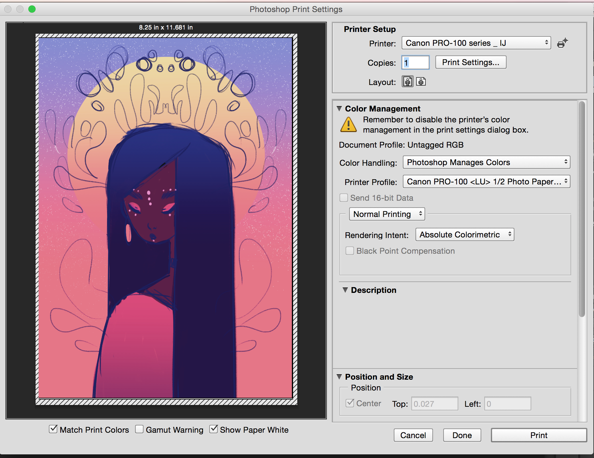

Can you take a screen shot of the print dialogue window of your art software? Should be something like this:

Here's the screenshot
