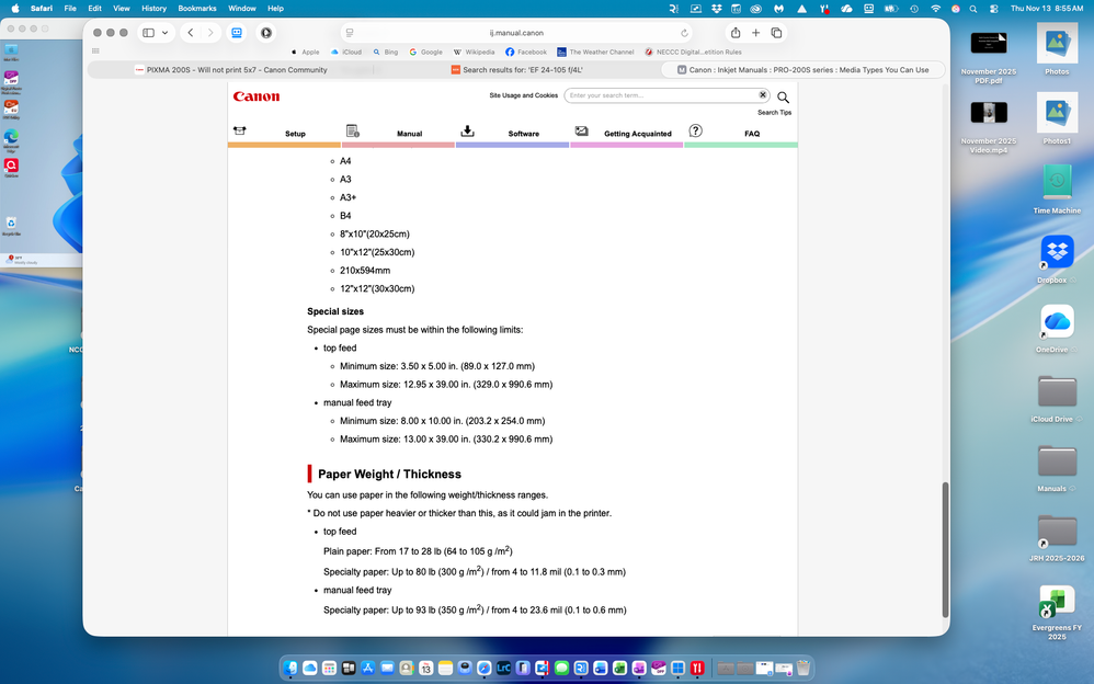

Does your cardstock meet these limitations?
