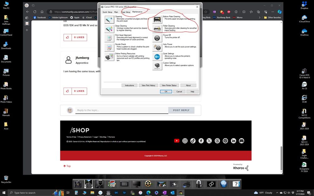

01-17-2024 12:15 PM
I am having the same issue, with no luck. How can access the rollers to clean them?
01-17-2024 03:18 PM
In the printer driver:
