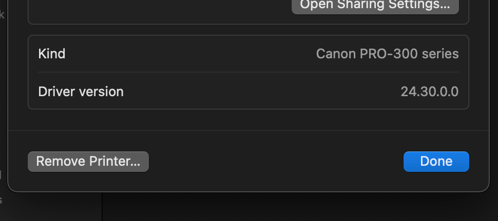

However...I do believe I solved the AirPrint problem. When adding the Pro-300, macOS automatically selects "Canon PRO-300 series" as the software. This creates the AirPrint version. However if you toggle open the Software dropdown, select "Canon PRO-300 series" from the list, THIS adds the Canon driver. Here's what I now see, which I believe to be correct.
It's confusing, for you see "Canon PRO-300 series" when automatically or manually selecting Software, but the latter loads Canon's driver, not Apple's.
01-16-2023 09:27 AM - edited 01-16-2023 09:27 AM
The 24.30.0.0 is the driver you want. I suggest you just delete the AirPrint version by selecting it and then selecting Remove Printer.
Now your color management should be correct.
