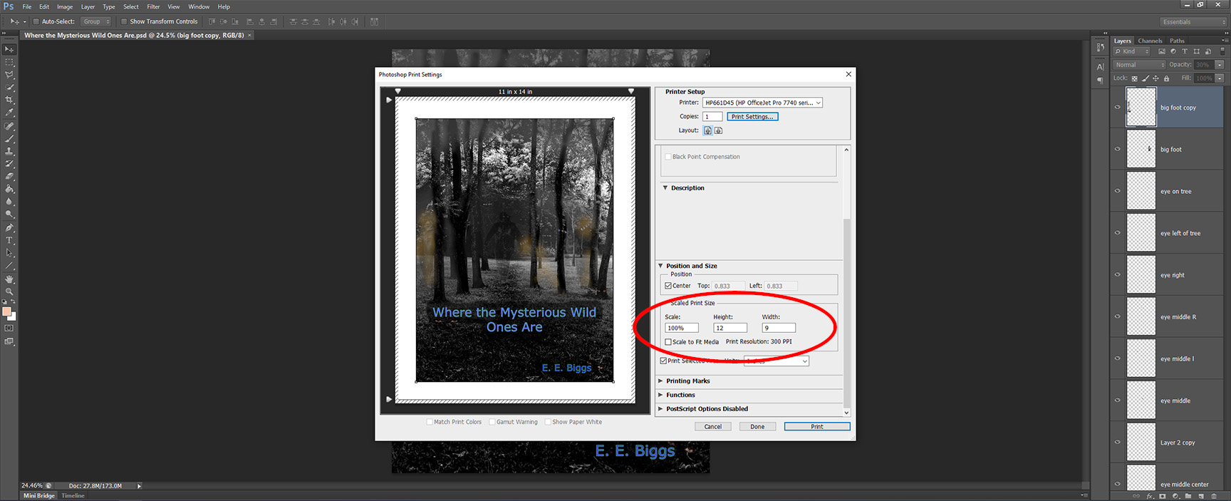

I tried to use the suggestions here, but with input of 14X17 printing at 11X14 from photoshop I got an 11X12.6 print on my 11X14 paper. Close but not there; I need help. Thanks in advance. Pixma Pro 10 printer

"I got an 11X12.6 print on my 11X14 paper."
What did PS say here?
My print is 12x9 but yours should say 14x11.
