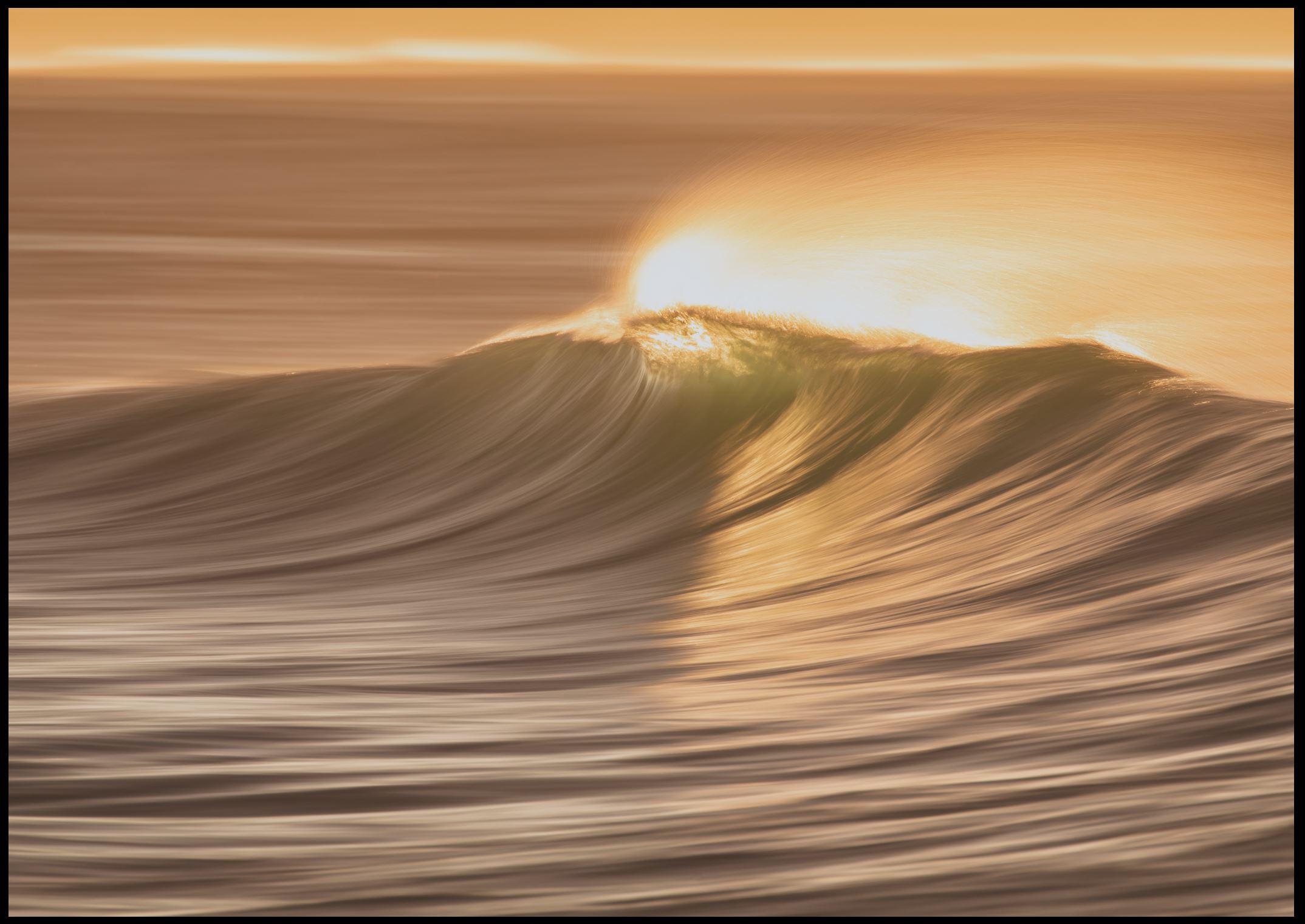

I went with Soft Proof first.
The first image shows no paper profile applied. The image shows up as I would want the print to look like.
The second image shows the paper profile applied. I have tried 3 different paper profiles. The manufacturer's profile and two profiles I created. They make the image appear darker, however they don't differ amongst each other. Since the image appears darker, it probably explains why the yellows turn orange, and orange turns into orange brown. I think the images show exactly what I am experiencing. The printer can replicate the colours, but it appears the print profile changes the colours in the wrong way. Can this be solved and how?
PS: I should mention that below shows up a little bit differently to what the saved files look like. The bottom image is much darker and orange than the upper image.
As you show, LR is not color managed, so the on-screen image outside of softproof will not show how te printed image will look.
Since you are getting good correlation between print and the softproofing image you can adjust the image in the softproof mode to produce hat you want on screen. Then it should look how you want on paper.
Softproof module will allow you to create a proof file which will be the edited image including softproofing changes.
