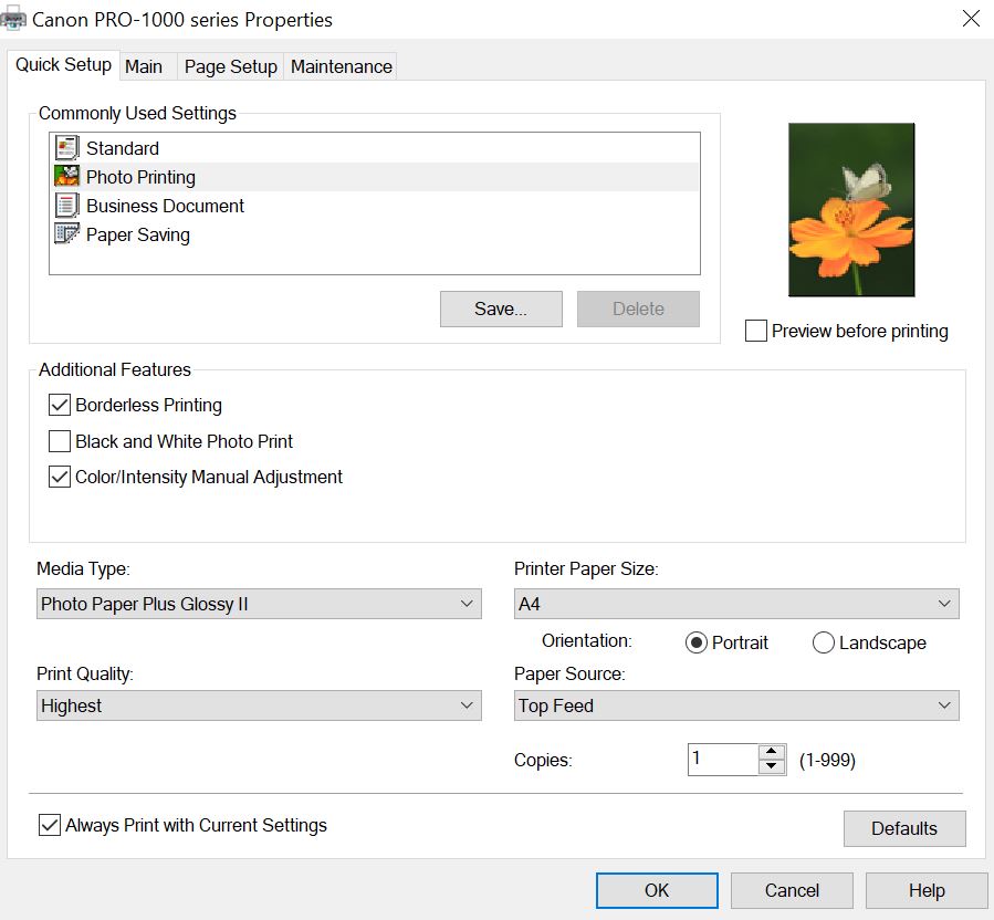

Over the last few days, I have installed my new Canon Pro 1000. I am using a PC with Windows 10. Before I started using the printer, I wanted to make sure, I know everything there is to know about monitor calibration, print paper profiles etc. Even though I have done everything the way I should, my prints come out different to what they should. I can see that my yellows, turn slightly orange and my blues turn slightly green. The prints are usable but not perfect, and much darker than shown on the screen. I will describe my print process below, and I would welcome your feedback on where I might have gone wrong.
My monitor has been calibrated using the X-rite Colour Munki, and I have cross checked this process and it's results a few times. I think I am good here. Paperwise I use the Ilford Gallery Metallic Gloss. First I started installing and using the ICC profile provided by Ilford. Using Lightroom as my print module, I have selected the ICC profile provided. Important to note, that I tried Perceptual and Relative without any difference.
To prevent double profiling, I chose Photo print in the printer properties. Important to mention I tried with and without 'Preview before printing'. I clicked into the Colour Intensity/ Manual Adjustment Menu and chose 'None' in the Matching Tab. On the Canon print module, I selected Photo Paper Plus Glossy II, as that is the closest paper type, and you can't add custom papers here. Please see below images for the settings I picked. With these settings in mind I didn't achieve a colour match. Please continue to read below.

Welcome to the forum.
I have a few suggestions:
1. I never use the Preview feature. I have seen posts on the web where it gives strange results. I recently did a trial when trying to help someone else and confirmed (to me at least) that Preview can look bad but actual prints are good. See this posting: https://community.usa.canon.com/t5/Professional-Photo-Printers/Pro-100-color-management/td-p/281676
2. I have the Pro-100. All your settings in Lightroom and the driver look correct.
