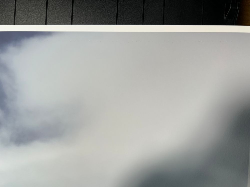

I have been getting 5-6 short black streaks near the end of my prints... and only some images have them... sometimes, I'll just keep reprinting the same image and 1 time I got lucky and the streaks didn't appear. Obviously, I cannot keep losing money through ink and paper like this. I've tried cleaning and deep cleaning and checking the pattern but nothing has made a difference. It shows up on matte and luster and metallic papers... I'm not sure what to do at this point?

I am having the same issue using Off Canon Paper. It's short lines.
I have run maintenance for 1) Roller Cleaning 2) Bottom Plate Cleaning 3) Clean Print Head
I'm using the Rear Feed and it's been a recurring issue since I've purchased the printer in July.
I print mostly Vintage art that has lots of texture and on those style prints..I am ok getting away with these marks.
But the fine art stuff is an issue and this would be a deal-breaker for keeping this printer. I'm ok doing a manual clean or some alternate method, but these marks are consistently happening in all areas of the print...well it does seem to like having them in the upper left corner a lot.
I print probably 50 prints a week and the paper is matte 200 GSM Inkpress Media Matte 60.
Hoping someone has a solution for this or a work-around for this issue?
