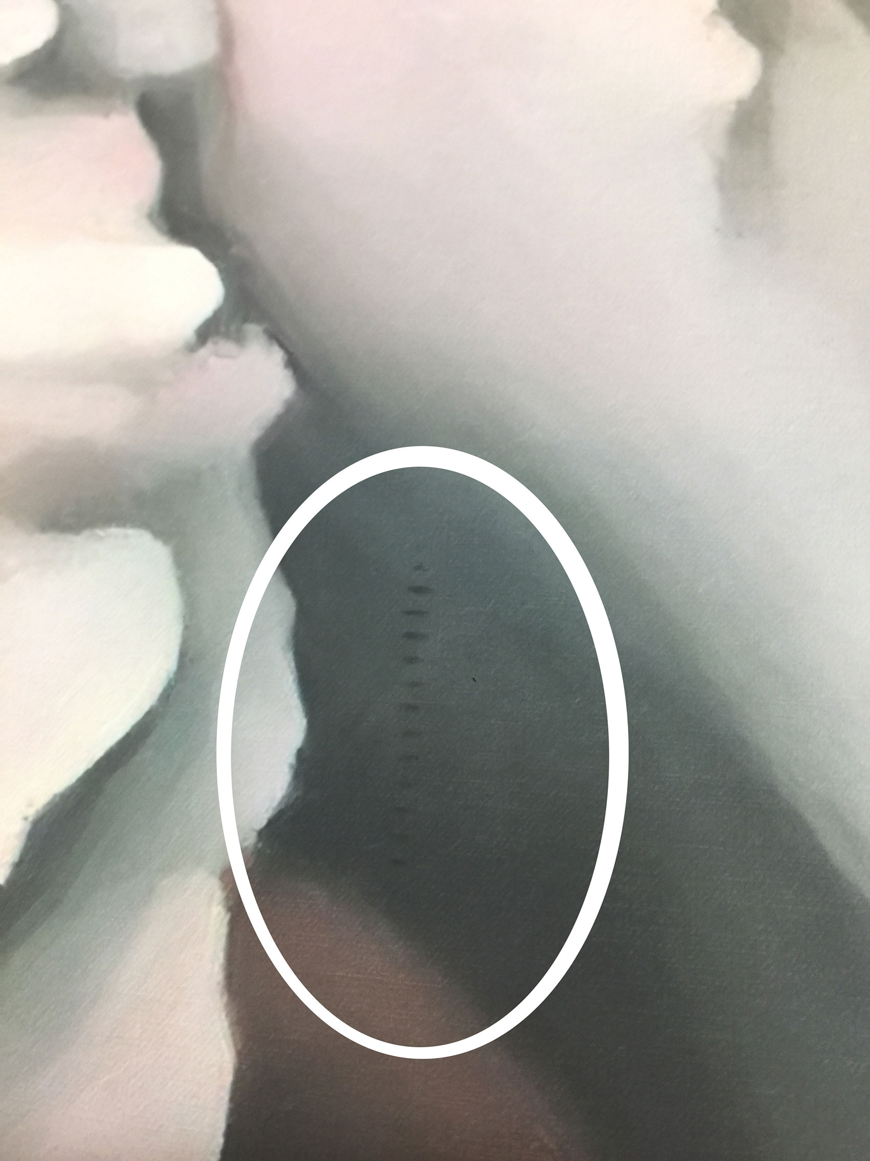

I have been getting 5-6 short black streaks near the end of my prints... and only some images have them... sometimes, I'll just keep reprinting the same image and 1 time I got lucky and the streaks didn't appear. Obviously, I cannot keep losing money through ink and paper like this. I've tried cleaning and deep cleaning and checking the pattern but nothing has made a difference. It shows up on matte and luster and metallic papers... I'm not sure what to do at this point?

Maybe some ink has gotten on the rollers or printer frame members? Does the Pro-1000 have a roller and bottom plate cleaning option?

I am having the same issue using Off Canon Paper. It's short lines.
I have run maintenance for 1) Roller Cleaning 2) Bottom Plate Cleaning 3) Clean Print Head
I'm using the Rear Feed and it's been a recurring issue since I've purchased the printer in July.

But the fine art stuff is an issue and this would be a deal-breaker for keeping this printer. I'm ok doing a manual clean or some alternate method, but these marks are consistently happening in all areas of the print...well it does seem to like having them in the upper left corner a lot.

Try contacting the manufacturer of the paper to see if there is a specific media type setting that needs to be used with that paper.
Also, try performing roller and bottom plate cleanings to see if this will help pick up any excess ink from the rollers. Details about these procedures can be found at the following links:

Thanks..I've performed both procedures and previously this wasn't a fix.
I'm using a new paper and the issue is resolved so far.
On the previous paper, I only did the printing a few times but changed the paper thickness setting and it appeared to work?
On the new paper, it's back to the old setting...so indeed, the paper and the setting to the paper is a big factor. Thanks.
