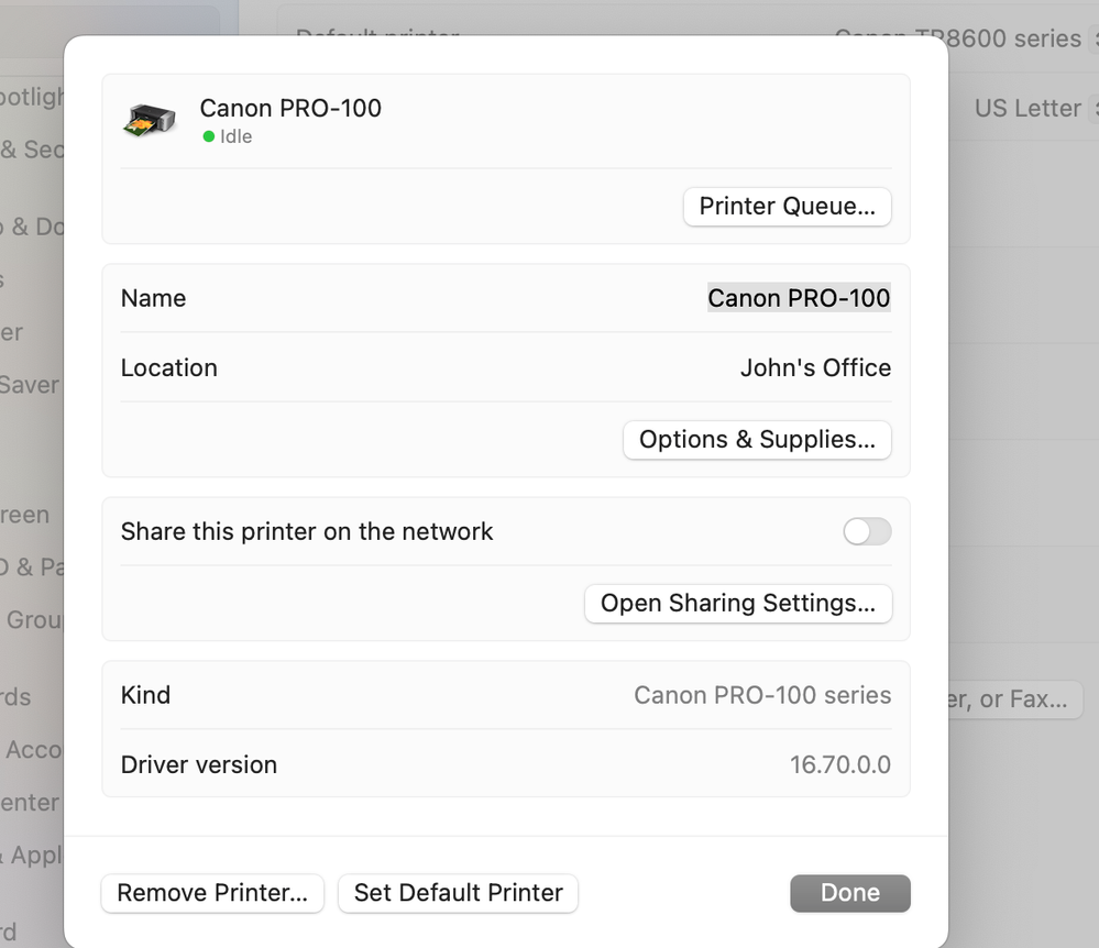

Have you downloaded the latest driver and ensured that you are using the IJ Series version of the printer and not the AirPrint version?

Screenshot 2023-03-22 at 9.22.41 AM.pngScreenshot 2023-03-22 at 9.22.41 AM.png

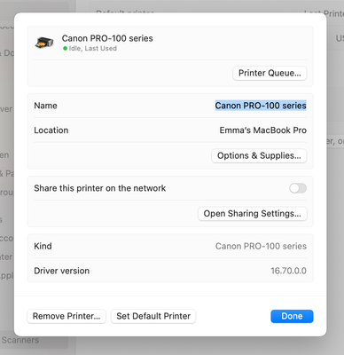

Hi John,
thank you for your response. I updated my Mac to the latest version (Ventura) and downloaded the most recent driver (16.70.0.0) and it is still printing everything with the red/pink hue. It’s mostly skin tones that are coming out too red.
