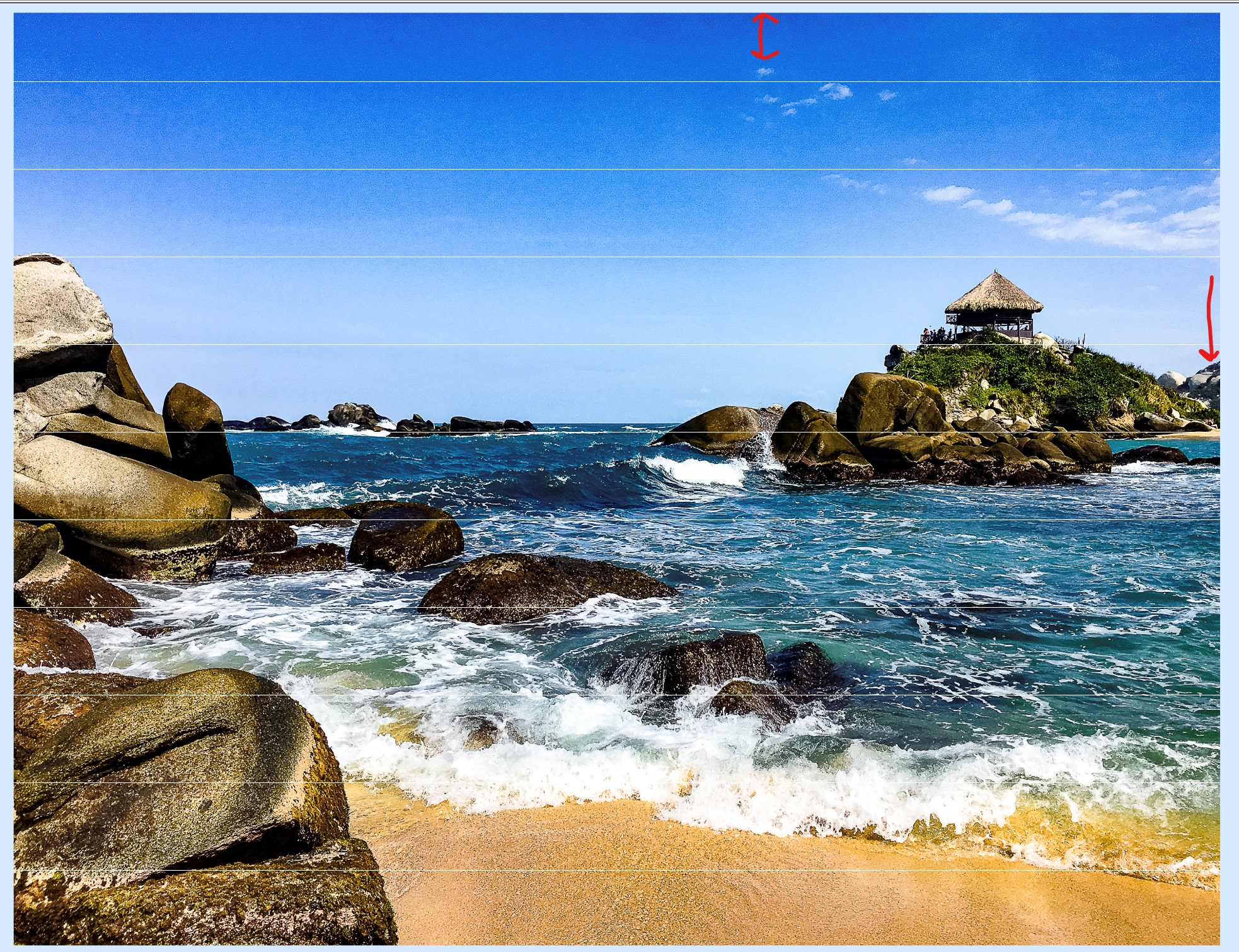

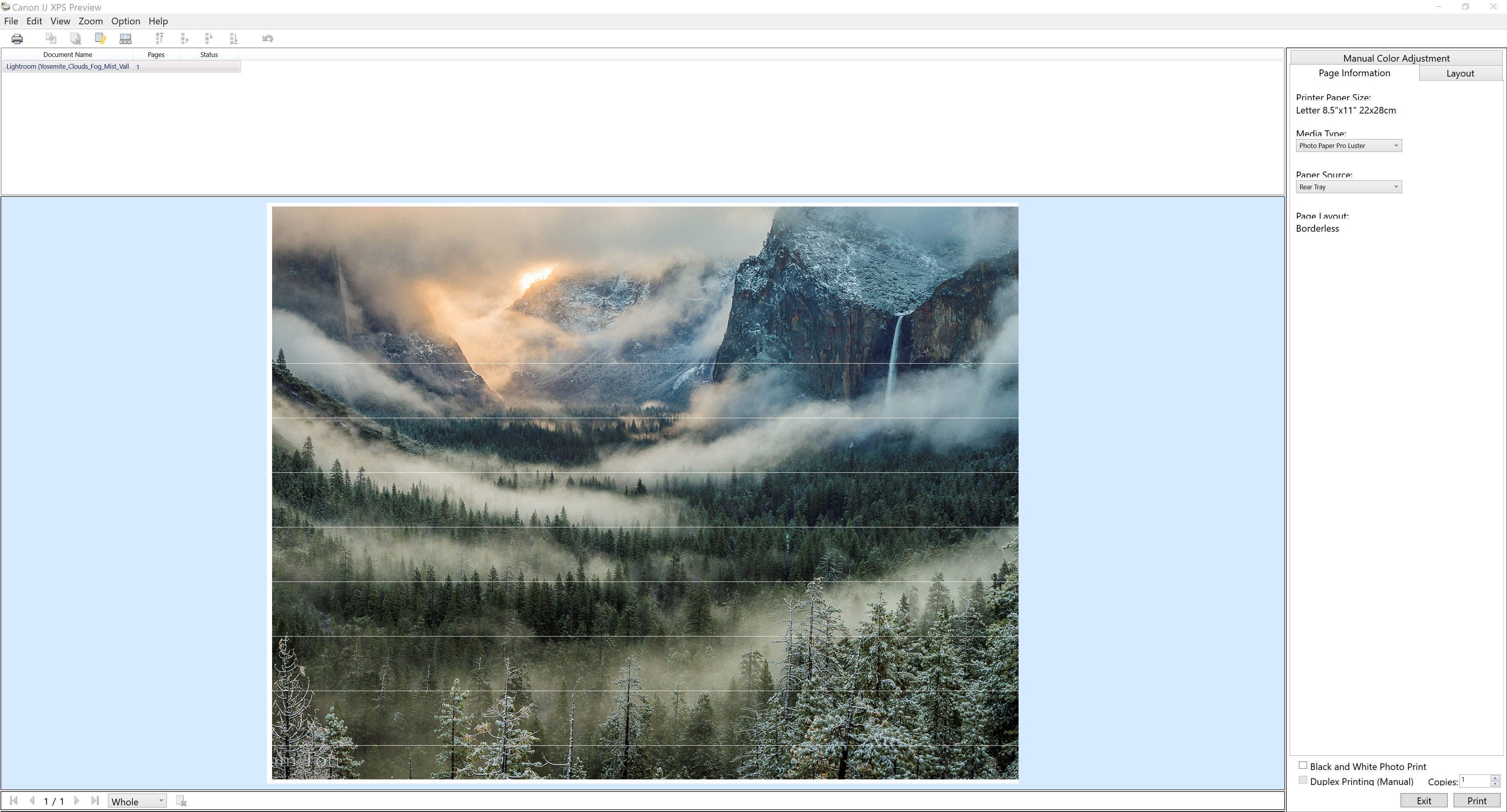

See attached pics...Can someone help idenfity this as either Canon Pro 100 printer problem or a Lightroom problem? Or another problem I'm not seeing?
In LR, I'm trying to print with the margins set and they look fine, but the Canon IJ XPS Print Preview shifts the image and throws off the margins/border, mainly on the RIGHT SIDE, and on printing, the top margin is also off (thinner). Don't mind the white lines across the print preview, they didn't print like that.
Alignment and test prints are all good with the printer.
Let me know what other relevant information you may need...thanks!

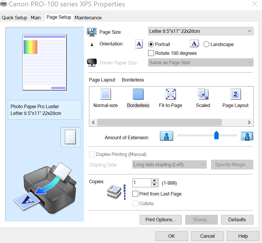

The printer has certain maximum printable areas for different papers, as shown in this screenshot:
If you select Borderless the printer driver will expand the dimensions of the print to try and fill the paper; you can't get a defined border using Borderless.
You should be able to increase the extension of the bolrderless setting to fill more of the paper.
But what are you trying to achieve - a borderless print or a print with borders of a size you want? If you want borders, and even borders, you need to select 0.25 as the margin on all four sides since on two of tghe sides 0.25 is the default margin.
I noticed you selected matte in the sharpening section. Luster paper is considered glossy as far as the sharpening algoritm is concerned. If you like the results then that is fine, but the default algoritm assumes any paper not designated as matte is glossy.

mdrx2011
Here's the end printed product, you can see the top and right margin issue...(oh and don't worry, I've calibrated my monitor and the printer prints accurately, it's just the lighting I'm using!)

Hello and thanks, jrhoffman75. Based on your questions, I did some further testing...but to no avail.
1) Tested without printer preview, got the same result...doesn't LR link directly to those printer preferences from the XPS driver I set as default? Can I bypass those Canon printer drivers in LR and get LR to manage all those printing preferences?
2) Sorry, was unaware you can't click on the image to load larger. I'm using a 8.5"x11" letter sized Canon Photo Paper Pro Luster LU-101. I set the printing preference as borderless initially so I can tweak the margins in LR to my liking. However, I've tested the margins on the print even when borderless is unchecked and have the same issue...the image printed is shifted to the top and right (compressing those margins)...
[][][] It seems the printer driver is setting different print dimensions/margins than LR.
Also attaching settings pics from the orignal prints, and note I set the cell size for that on purpose to create the margins I want:lightroom-canon issue4.pnglightroom-canon issue5.pnglightroom-canon issue6.png
Borderless printing (with no cell size adjustments to create a border, all other settings equal):
On these borderless prints, the top and right are compressed in the preview, and also slightly more on the print itself...
