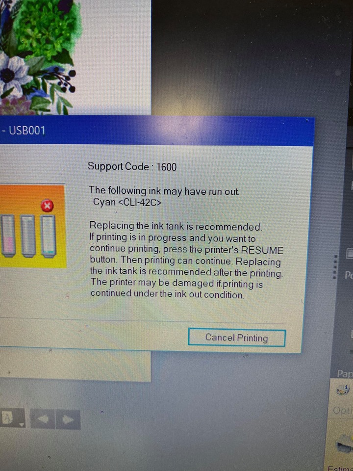

My canon pixma pro 100 is saying my cyan ink is empty and it is full, yes the liquid part, I tried turning it on an off and that didn't help. Ink cartridges are too expensive for them to only work 10%104321947_1672024162956428_7020931288169263438_n.jpg104321947_1672024162956428_7020931288169263438_n.jpg

Is this a brand new ink cartridge, or is it one that has been in the printer for a while?  The ink level is estimated based both on the ink tank's age and on the ink that has thus far been used.
Additionally, some ink will remain in the ink tank once it has reached "Empty" status.  This is to prevent the print head from being damaged by lack of ink.  Typically, the remaining ink level will be lower than what is shown in this image.
Is the ink refilled or remanufactured?  Canon genuine inks are not designed to be refilled, and so even if ink is added, it will report according to the last known good level.

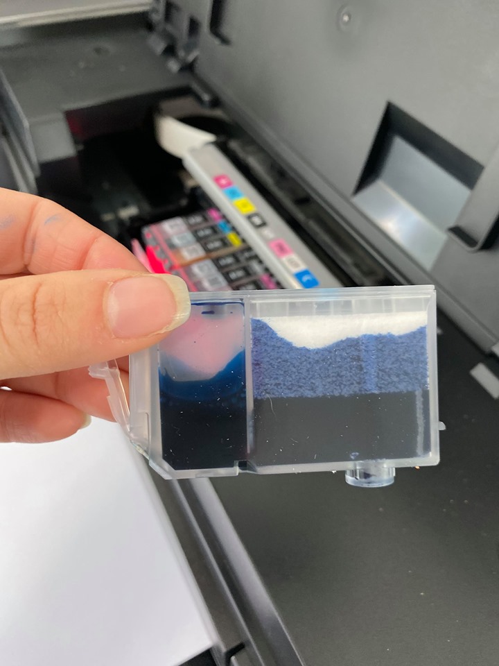

Hello,
I have the same problem but with the printer PRO 4000, the ink that has been leaking are MBK and PC. The ink leakes in the sub tank underneath the cartridge.  If you have an idea what could be the problem with my printer I would be very grateful. I have been trying to fix this problem for days and an additional problem is that I live in a smaller country so there is no possibility of printer service.

So It never stopped doing this it would do a different ink every time, I did call support and they had no answers for me, but you can hold down the button (the one that flashes orange) until the orange light stops and it will print regardless, it will still tell you when the ink dries out completely, but I tend to check more often just in case as I heard running it dry can be really bad for the printer.
