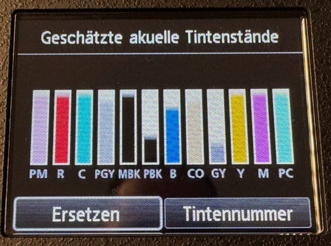

I transported my PRO-1000. Before transport, the ink cartridges looked like this:
I would call 10/12 of those full. I have replacements at hand for PBK and GY.
No on restarting, the printer is showing all cartridges as empty and requiring replacement. I can feel how full they are. They're properly heavy, full ink cartridges.
Can I force the **bleep** printer to complete the after-transport set-up cycle without replacing all the cartridges?

I weighed the cartridges. The partially full ones are showing around 85-90 grams, while a new cartridge is 118 grams.
A cartridge has 80ml of ink. The internet tells me ink weighs 1.05 grams per ml. My cartridges are something over 67% full.
