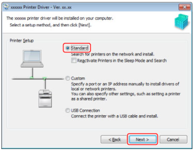

What option are you selecting here:

Hi and thanks for responding! I have an acer all-in-one computer (desktop) and windows 11. I did create a pin during set up and I am trying to connect wirelessly.
When you say, Assign or reserve a static IP for the printer, what does that mean? There's a place in the setup process on the desktop where the screen shows that it cannot find the printer. It says you can add the IP address manually. There's an IP address in the printer information so I typed that in and it still didn't find the device.
