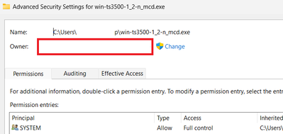

First. Right-click on the file, Select Properties >Security tab > Advanced button. Who is the owner? If the admin user you are logged in as is not, Take Ownership. Ensure this user has Full Control. Delete any unzipped directories or folder and unzip again, then run.
