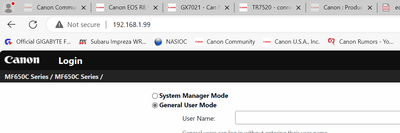

Do this from a web browser or command prompt.  Example, my printer is assigned IP 192.168.1.99.
Web Browser:
Command Prompt:
