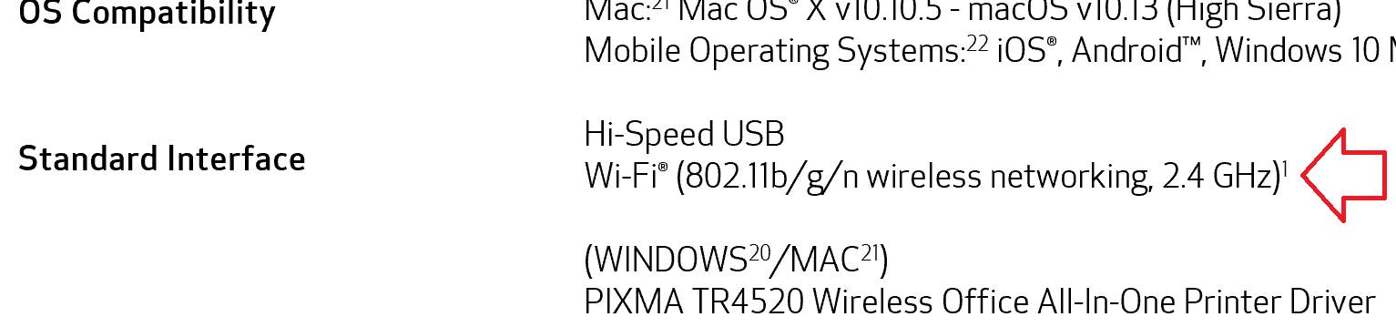

02-06-2020 12:36 AM
From TR4520 specs. page.
Wireless support, 99% of printers (all brands) only support 2.4Ghz wireless, not 5G.
02-06-2020 06:03 AM
Thanks. I don't think I even bothered to look at that spec because my 2017 model year TS5020 had been connecting fine to my 5 GHz router for almost a year. I believe I had even tried manually entering in the SSID into the TR4520 and it could not find it.
