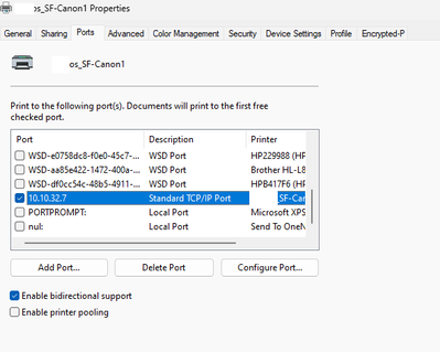

Ok, I think I have all of your setting in place and returned the settings back to auto in remote UI for IPV4 Now I'll just use it as I have been and it should retain the ip. Here's what the printers came up as in the properties panel. Before it had an actual picture of the MF750 but it's no big deal. Thank you sincerely for your help and patience.
07-17-2023 07:46 PM
Looking good. One last thing to check.
Right-click on printer > Printer Properties > Ports Tab
If the printer is added as an IP printer. Its IP will appear with the check mark. Yours will be the IP you assigned.
Good work! Have a beer. You earned it.
