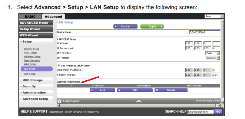

I opened the menu on the router, and it was already entered. did a screen grab to show you:lan.jpglan.jpg

The RAX50 is a Netgear product.  Stephen has referenced the correct instructions and your image shows where its done.
Under > Address Reservation
Here you go.  Your router is using 192.168.1.0/24

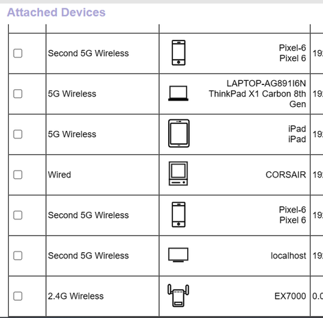

Any IP between .2 and .254 can be assigned to the printer.  Once its connected to the network, you can look in "Attached Devices" on the router and confirm the IP the router has assigned to it.  It will display the MAC address of the printer's wireless adapter as well.
Return to the Address reservation and press "Add".  Enter the assigned IP address.  Name can be whatever you like.  Enter the MAC address .  Press save.  Once the reservation is set, restart the printer.  The router will assign its reserved address to the printer.  Note, if you changed the printer's DHCP settings from "Automatic" you'll need to re-enable that for the printer to accept the IP address assignment.  If an entry for the printer exists, then you've already performed the steps and can continue.  (including this for others)
