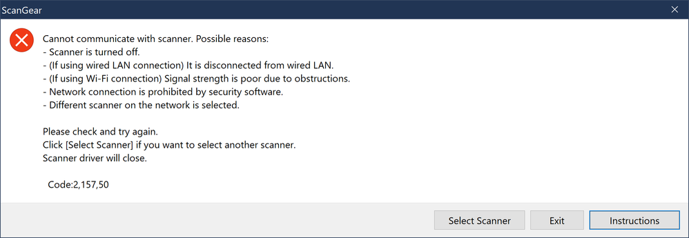

Trying to scan through network from 2 different computers with same issue. Use to work fine months ago, but now I'm trying to scan from a TR-7000 copier and it goes halfway and then I get an error. I can still print. Well, it wouldn't print either until I unplugged the copier. First, I could see the printer stats and then I couldn't print and couldn't see the ink stats and I still can print. Single is fine since I can still print. I still can scan using the USB.
I've noticed this problem ever since I had my copier firmware updated. I also tried updating my copier drivers and still no luck.
Note: I can preview from Scan Gear, just not scan. I can't use Canon IJ Scan Utility at all.

I just unplugged the copier and had problems previwing twice and on the 3rd preview it worked using Scan Gear.
Seems like the printer times out to easly.

It is a TR7020 with both computers running Windows 10.
This was not a problem until my printer did a firmware update from the printer. No software update at the time it won't scan and only scanning is affected.
05-04-2023 02:56 PM
I just did a single test. I moved the printer closer to the router and it scanned just fine with 3 out of 3 bars.
The printer shows 2 out of 3 bars from where it was before. Enough to print but not to scan. The scanner can't send 25 feet away through some walls apparently. I have a computer right next to the printer and has 4 to 5 bars using Wi-Fi and it can send just fine. There both 25 feet away from my Wi-Fi router but the scanner can't send that far. Meaning that 2 out of 3 bars from printer means nothing when it comes to sending from scanner. Weak single.😥

Can you explain to me why I can't scan at 60% single strength that is not enough for scanning but still can print just fine from computer?
