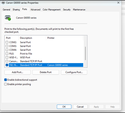

I have a G6000 series printer being shared by 2 computers via WiFi. The computers are connected to the router via ethernet. I recently upgraded one of the computers to Windows 11. Since then when computer A prints a job everything is fine but then when computer B attempts to print it gets a printer off line message. If we turn off/on the printer the computer B job prints but now computer A gets Offline message when it attempts to print.
I have removed and readded the printer on both machines but no help. It appears the printer is not releasing the bind.
any suggestions.

02-10-2024 04:46 PM
the static ip address of printer is 192.168.1.26
the ip address of computer a is 192.168.1.27 (static IP
ip address of computer b is 192.1.28 (static IP)
ping from Computer A is immediate
ping from Computer B was 'UNABLE TO REACH' turned printer off and back on and the Ping was immediate.
went back to computer A and ping was successful.
reviewing ports of computer B print defination saw port was mis-configured. added new tcpip port like this
now both computers list a configured port as in this screen shot.
I bounced between computers printing test pages and both computers printed without issue.
So this appears to have been a misconfigured port. (hopefully)

02-10-2024 04:46 PM
