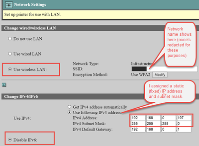

Truong Vu, your solution will more than likely work or at least be part of the solution for some people experiencing this problem (may also need to assign a static IP address to the printer). However, by disabling IPv6 the way you recommend will disable it for everything; and now that IPv4 addresses have run out of assignable numbers, newer technology is taking advantage of IPv6 more and more.
By accessing the printer's Network Settings page via a web browser as described by Bob4's solution, you can disable IPv6 for only the printer; thereby leaving the overall IP settings set to access IPv6 when necessary.

I was agreeing with your solution for the most part; however, the path to disable IPv6 that you cited in your post doesn't exist as such in the home environment running Windows 8.1 or 10 standard. In order to access the Web Services settings at the device level, you need to enter the IP address of the printer's WS properties in a browser. One way to do this follows:
1. Right-click on the Windows icon in the lower left corner of the desktop taskbar.
2. Left-click on Control Panel.
3. Depending on your view - Category (default), Large Icons, Small Icons - left-click on either:
a. Hardware and Sound --> View Devices and Printers (when viewing category); or
b. Devices and Printers (when viewing large or small icons)
4. Locate your printer model series WS device icon or name and right-click on it.
5. Left-click on Properties
6. Left-click on the Web Services tab at the top
7. Under Device Information, you should see a line labeled "Webpage" in the middle of the window with a hyperlinked URL that looks something like "http://192.168.0.197:80/index.html". Left-click on the hyperlink or copy and paste it into your web browser, e.g. Google Chrome, Firefox, Opera, IE, etc.
8. Your browser window should display the printer Network Configuration. Left-click on Advanced button:
9. Next, locate the side-bar on the left-side of the page and left-click on Network Settings:
10. This brings you to the page where you disable IPv6:
