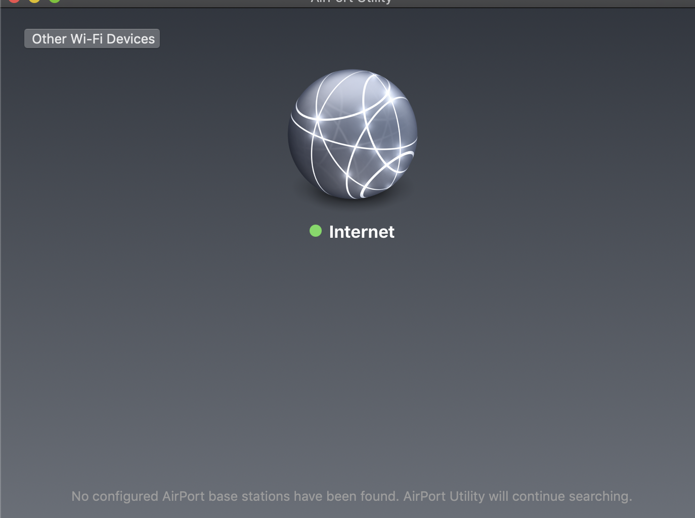

I'm having the same issue since I moved my printer to our new office with a different router/network.  So I followed the steps outlined above but now have a new issue, and I have no idea how to fix it.  Here's a screenshot of what my airport thing looks like.  When I click other wi-fi devices it doesn't seem to be able to find any.  If you have any advice, I'd sure appreciate it.  Super frustrating trying to reset the printer everytime I want to use it.

If you search on mx922 will not connect to Airport Express on 12/11/16 answer is given on 12/13/16 with most likely issue that Airport Express does not have WPS button on Router. The answer on 12/13 steps through standard setup which also can be found for windows or Mac on YouTube Now, just type in MX 922 on Youtube and it has the steps to setup standard setup via downloading latest software for MX 922
