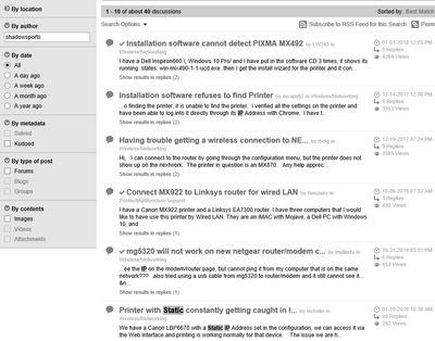

**Also, if you seach my username and "static IP" you'll get many, many hits.
