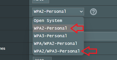

Greetings,
This printer model supports 2.4Ghz wireless that uses WPA2 /AES encryption. Please ensure your network supports these requirements.
In the case of a dual or tri-band router, using the same SSID name can sometimes cause connection issues.
Some options are; using a unique SSID name for each broadcast. You can also temporarily disable 5G broadcasts while making the connection, then re-enable. You should also ensure the broadcast uses WPA2 encryption. Some devices allow WPA3/WPA2 for backwards compatibility. You can also use WPA2 on its own. Its very secure.
