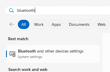

Close the Canon Print App
Press the Start Menu button
type "bluetooth and other device settings", select it from the menu

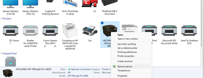

Now scroll down and look for "More Device and Printer Settings"
Select that. Now one by one, right-click on the duplicates, (copy1, copy2, copy3) and select Remove Device from the context menu. When you open the Canon App again, they should not be present.
