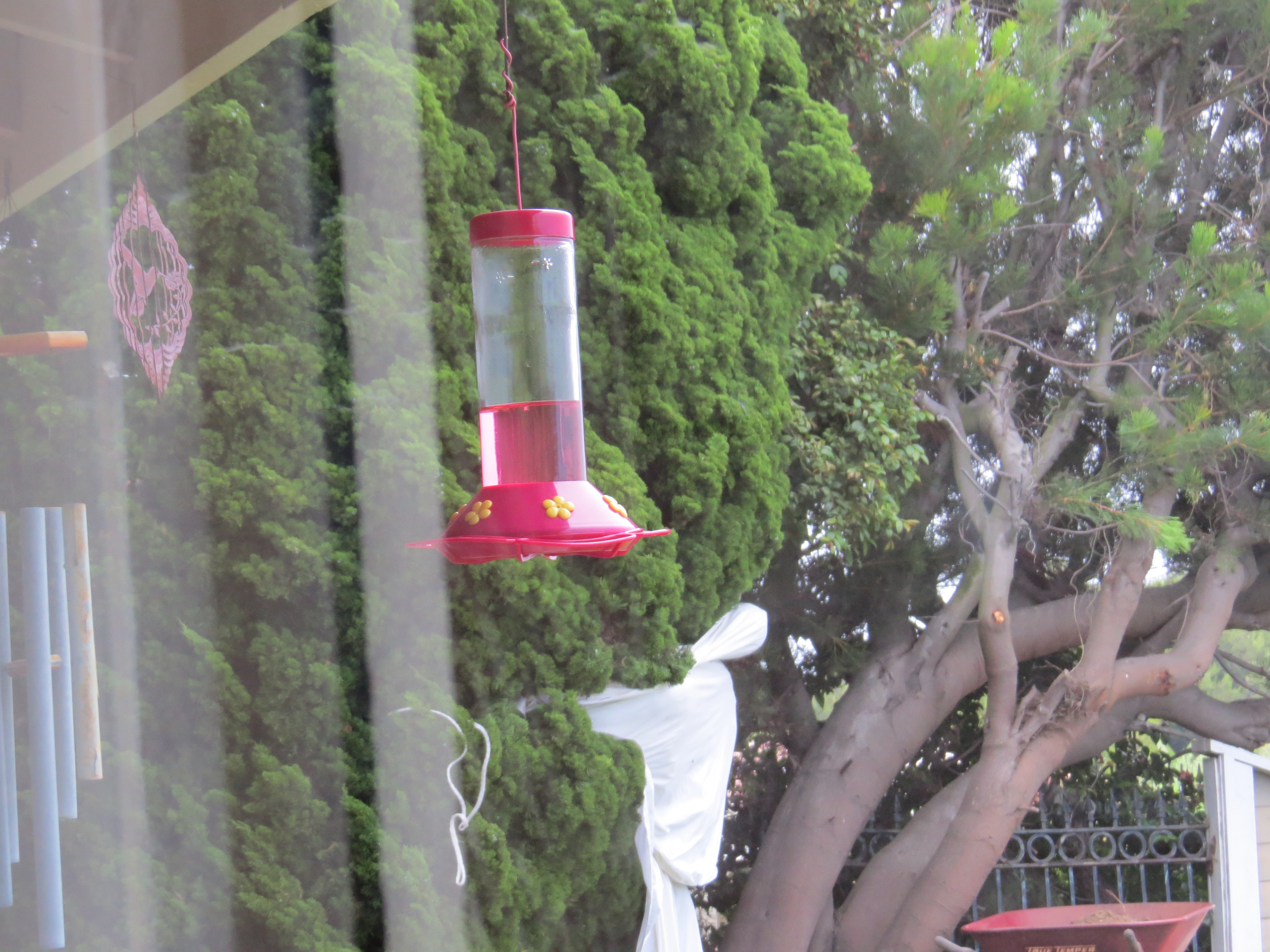

I'm in total agreement with Murry, and that is, Linda, the best way to learn what works and what doesn't is to experiment and have fun doing it.  To that end, you got my curiosity up and I experimented myself this morning with my camera taking a few shots through windows in full Auto mode.  I'll add the specific details of each shot below with each picture, but the overview of the pics is they were all shot in full Auto on exposure, Auto focus for focusing, and the first three were with the sun coming from behind me over the house and the last two I was shooting slightly into the sun and shooting at a bad, sharp angle to the window.  Anyway, here are the pics and the details:

Fourth picture was taken through a different window, slightly forward-facing lighting.  Also, please excuse the background...I'm doing some landscaping and have a tarp up.  Anyway, this photo was taken at a sharp angle and two feet from the window with the hummingbird feeder as the target.  Exposure was 5.6, 1/50, and ISO 800:
Last picture was standing up against the window and zooming at the feeder and bird.  Exposure was F5, 1/50, and ISO 800.  Some impressions of all these pics to follow in the next reply:
Some impressions for you, Linda, from the shots I took above and what I learned.
First thing is I was amazed at how well Auto focus handled shooting through the window, but I still don't recommend it.  If I were you and intent on shooting through a window I'd set up with a tripod if at all possible, and I'd pre-focus on your target area with manual focus so that your birds will have the best chance to be in focus.  Another thing is like with any kind of photography, try to get the best lighting conditions if at all possible through your window, so try to have the sun "at your back" as it were and not coming straight down, on the sides, or in front of you.
I don't know what your setup is at home or just how intent you are at photographing these birds, but I'd say if you're intent then a summary would be to try and use a tripod, use manual focus and focus ahead of time, use a remote shutter release if you have one, shoot perpendicular to the window, get as close to the window as possible, and be aware of your lighting conditions.  Hope some of the above helps you out.
