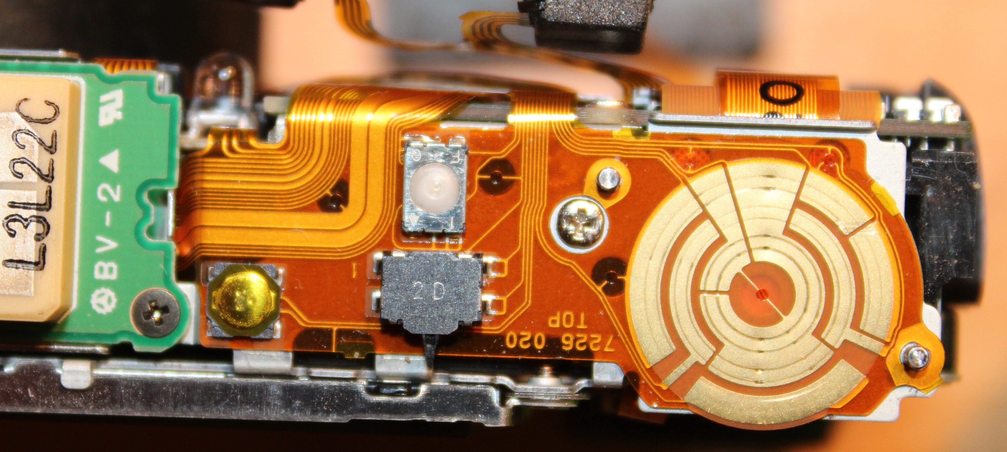

msostrowski...when you took it apart did you notice how the circuit board that holds the switch is mounted in there?
I uploaded a pic of the top flex attachment in my public album.  It's not the best pic, as I was only interested in the actual shutter button in case I tried to find a replacement, and unfortunately it's the only one I took.  You can get a good idea of how the flex is attached though - it is sitting and located by dowel pins directly on the metal top plate of the camera frame (you can see the frame through the flex).  It's a little hard to see in the downsized image in my album, but very clear in the original.
Shutter switch is the small tactile switch with the white actuator in about the center of the pic.  Zoom switch located directly behind it, and the mode dial contacts to the right and below both of those switches.  The screw visible between the mode contacts and the shutter button isn't holding down the flex, there's actually a clearance hole in the flex for that screw.  Didn't really look for what holds the flex down, most likely the top cover.

I also wanted to give something back so I took some pictures of the electronics inside since I saw that was requested.
And from what I could figure out is the circuit board glued to the metal frame and to get DeOxit to the tactile switch through the pushbutton I think will be quite hard.

wow great picture thank you for that !
The problems that you experienced after a while were the same as before as in the shutter button didn't trigger an exposure ?
From that picture it does not look like that circuit board can come loose and fall away from the mechanical shutter button but does it flex ? Or could it flex enough to create enough distance between the switch and the mechanical button.
It could all be from a bad batch of switches that the DeOxit somehow fixes it.

"From that picture it does not look like that circuit board can come loose and fall away from the mechanical shutter button but does it flex ? Or could it flex enough to create enough distance between the switch and the mechanical button."
No it all feels quite sturdy, the whole thing might flex a bit but I don't think it is something DeOxit would have fixed. I think the problem is in the switch itself, it might get worn out or something and the DeOxit just makes it get contact a bit better.
The first fix I actually tried was to put a small spacer between the button and the switch and that didn't do much good at all.
"I looked at the other pictures also..I couldn't tell if there is a rubber seal around the mechanical shutter button ?
Also it looks like there might be just enough room to get some fine needle point probes in there to test the switch when it is acting up or wroking even."
I didn't check if there was a rubber seal but I don't think so. Ya I guess you could bend the top plastic part a bit to get in that way but I would be careful about that, I rather just remove the screws. 🙂
