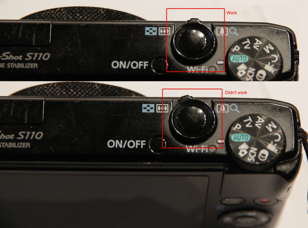

Just registered to report my solution.
I have a similar problem with the PowerShot S110 of my wife's sister.
At some time a menu button and all joystick buttons stop working.
The problem was because of sticking zoom control (yeah it's very stupid).
At the normal state zoom control must return to central position!
When zoom control is on the left or right position - some buttons don't work.
I hope this info will be usefull to someone.

06-28-2014 12:34 AM
When the zoom lever is off center it can take a picture, and play button and video rec button still works, and the wheel also work.
