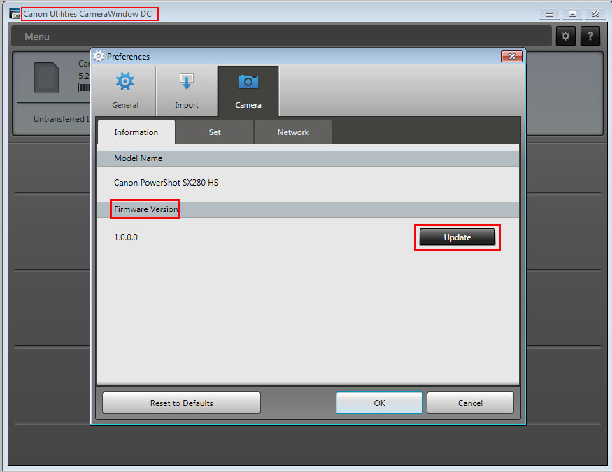

For what it's worth, SX280 owners already have a utility and instructions for updating firmware (see screenshot below). It is within CameraWindow, part of the software that came with the camera. If the "documented successful repairs" are merely firmware updates as was related to a fairly prominent camera reviewer, why would anyone have to send their camera in to be repaired?
05-23-2013 02:34 PM
Videophan: Yes, I noted the same thing. If it's a firmware fix, this would be the obvious way to install. I also show v. 1.0.0.
05-23-2013 02:54 PM
I would guess that Canon is [rightfully] willing to repair/update a camera before a firmware update is available for download. I don't know anything about the process of firmware updates, but there may be a more challenging step between having an update and configuring it for public, remote access(?)
