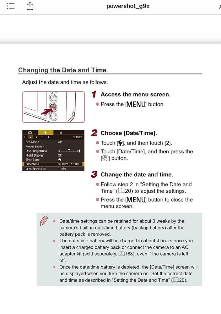

MikeSowsun
The G9X does not have a user replaceable date/time battery. It has a built-in rechargeable battery that is automatically recharged in about 4 hours by the main battery. If it is not recharging, it will need to be serviced by Canon.
This is from page 21 of the G9X user manual.
Mike Sowsun
Not exactly the news I wanted but thanks so much for your reply.  The manual was a little vague about the date/time battery being irreplaceable except by Canon.

MikeSowsun
Mike Sowsun
