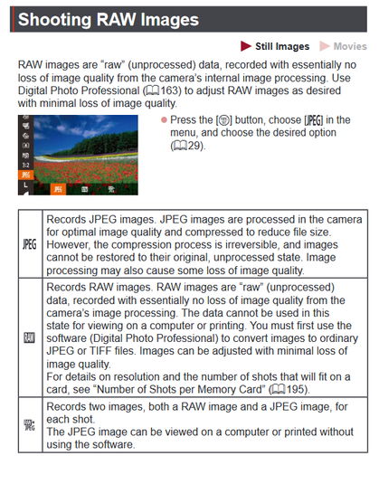

Thank you! How will I know if the image is taken in RAW?

On the computer: look at the extension, it will be .crX
On the camera, hit playback and press the info or disp button to change the data shown with the playback.
To set RAW, see P90 of your User Guide (which you need to go through).  For access to the on-line PDF version see: https://gdlp01.c-wss.com/gds/3/0300016123/01/psg7x-cu-en.pdf
I suggest you shoot in the bottom mode - both RAW and JPG, so you are covered either way.  RAW images need to be processed out of Camera in Post-Processing software like Canon's free Digital Photo Professional.
