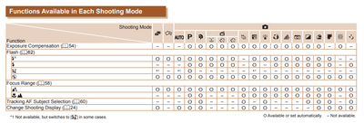

Selectable Flash options will depend on the shooting mode you have chosen.  You need to be in AE [P] mode to use all of the flashes selectable options.
Camera User Guide (c-wss.com)
Flash settings are on page 62.
Note the shooting modes where flash operation can be adjusted.
"O" = Available or set automatically
"-" = Not available
"-" = Not available
