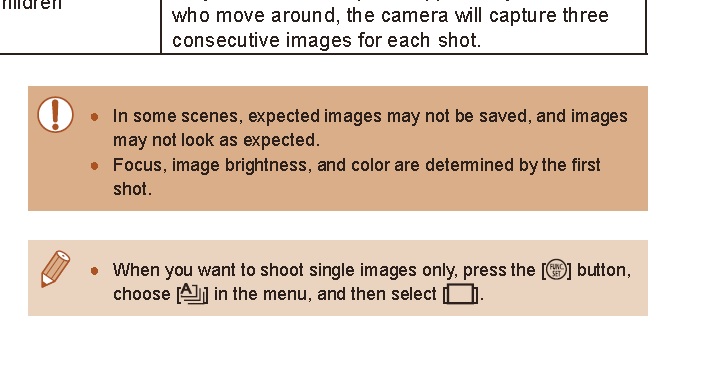

Download a copy of the manual here if you don't have one...
https://www.usa.canon.com/internet/portal/us/home/support/details/cameras/point-and-shoot/long-zoom-...
Take a look at page 37 and see if this helps sort things out. There seems to be some funny continuous shooting monkey business going on here in Auto Mode and Hybrid Auto Mode. At least it looks like you can blame your kids for it, if you have any.

Look at the bottom of the LH column on page 37...
Down here in the fine print it looks like you may have the option to defeat this "feature".

I really appreciate the helpful advice. I checked out everything suggested, but was not able to put my finger on the setting I needed to change. Realizing that I wasn't hearing from others experiencing the same thing, clearly this was something that I inadvertently changed. i reset camera settings to default, and sure enough, the issue disappeared. Still don't know exactly what I'd done, but given that it was a new camera, I was experimenting with various settings and obviously changed one that resulted in the multiple images. Anyway, all is well now and I am still quite happy with the pictures this little camera takes.
