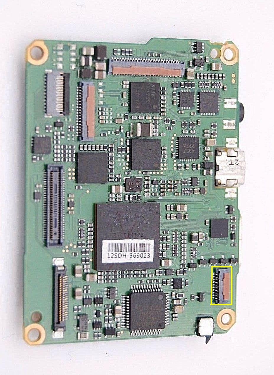

Thank you John for your quick answer, I found the problem, I disassemble the camera and this piece (the little lock of the ribbon cable) is loose from the main board, can be welded again? or I need a new board?
10-13-2019 07:29 PM
You're welcome! It is hard to tell from the pictures exactly how it broke or if that can be repaired, resoldered or perhaps use a quick setting epoxy? At this point, you have nothing to lose and more to gain. If the repair fails then you will need to replace the board. Resoldering it in place, if possible, would be worth a shot. If it is just the plastic piece that holds the cable then maybe a quick setting epoxy would work if you can hold it in place while it dries with a clothespin or something. You have demonstrated you have the courage and skill to give it a try, I would!
